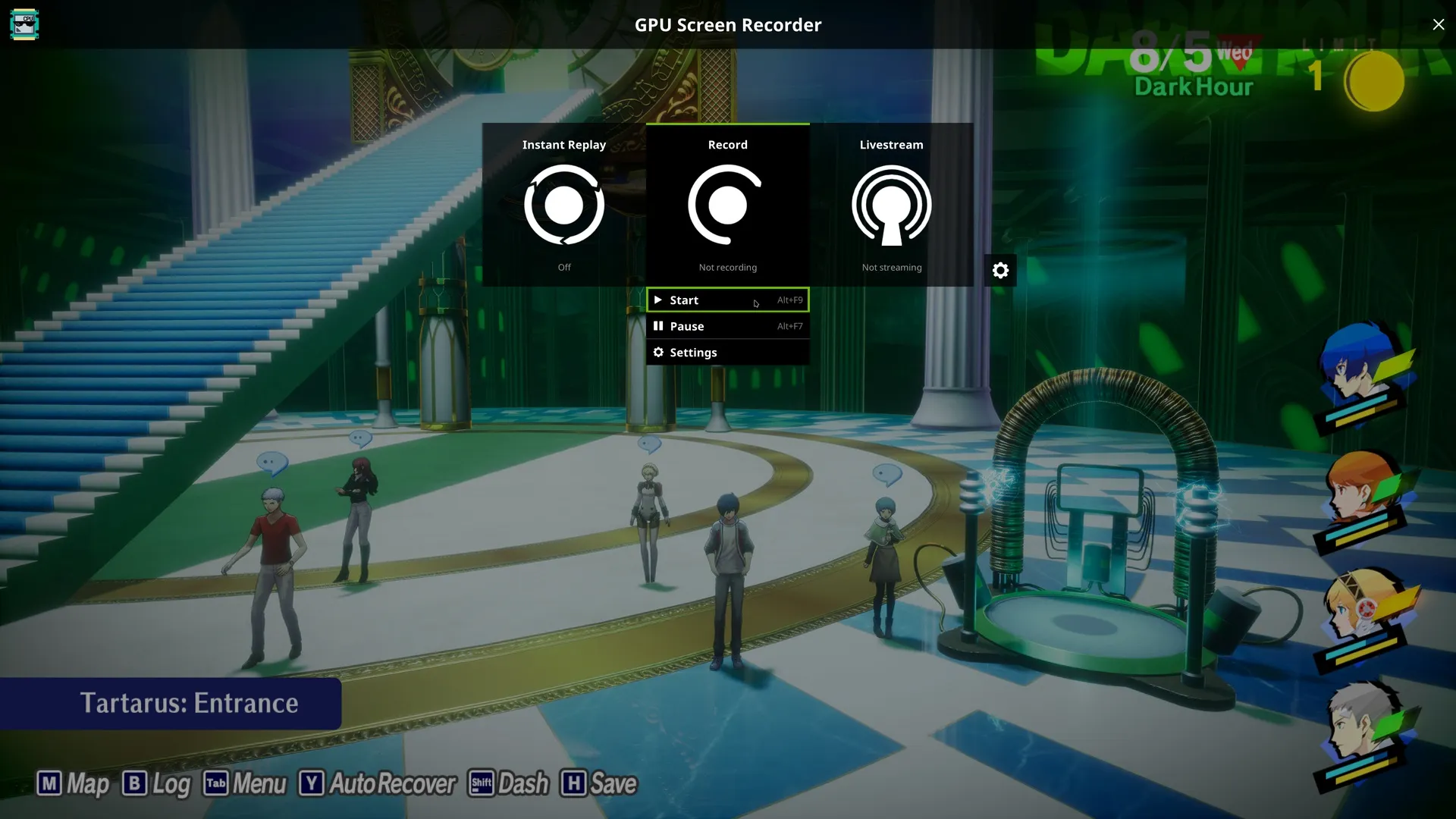

A shadowplay-like screen recorder for Linux. The fastest screen recorder for Linux
This is a screen recorder that has minimal impact on system performance by recording a monitor using the GPU only, similar to shadowplay on windows. This is the fastest screen recording tool for Linux. This screen recorder works with both X11 and Wayland.
This screen recorder can be used for recording your desktop offline, for live streaming and for nvidia-like instant replay, where only the last few minutes are saved.
