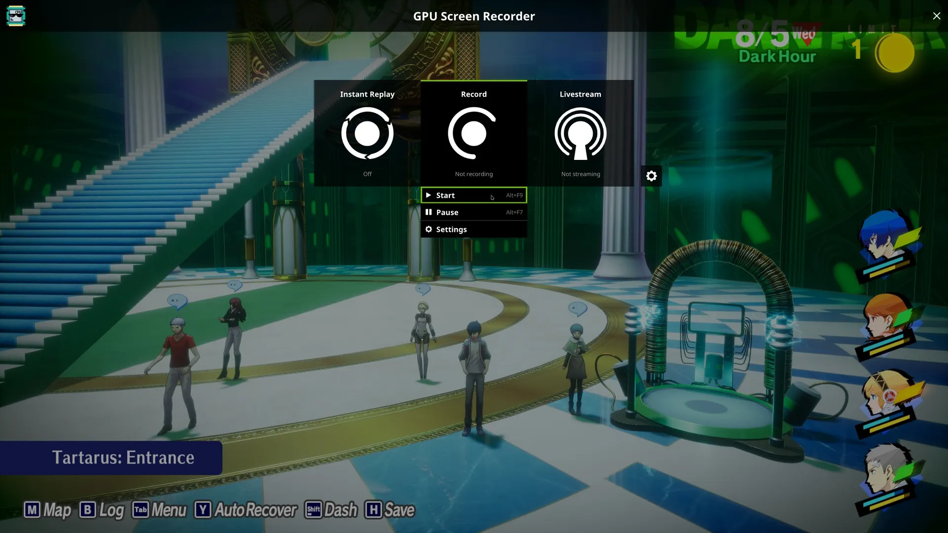

At the moment the program comes with two different UIs. A gtk based one and a new experimental ShadowPlay-like fullscreen overlay UI. The gtk based UI will be removed in the future. You can switch to the new UI by clicking on "Try out the new UI" and then after that is done press Left Alt+Z to open/close it.
